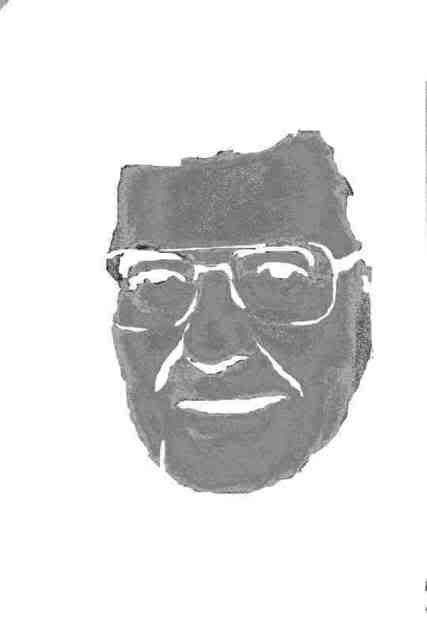

I really like this inlay and would like to do that in wood for my client. I think it is real classy.
I'm not sure how to do it, but I'm thinking that I turn the picture to black and white, turn up the contrast and saturation and it should be pretty close.
PostPosted: Thu Apr 05, 2007 4:16 am
Posts: 4820
Another very effective Photoshop method would be to go to:
Filter > Artistic > Cutout.
Then play with the different levels of break apart.

Steve, yes, that should get you really close. I usually edit the picture
"manually" too, either within photoshop, using the brush and pencil tools,
or with an actual pen or pencil on paper.

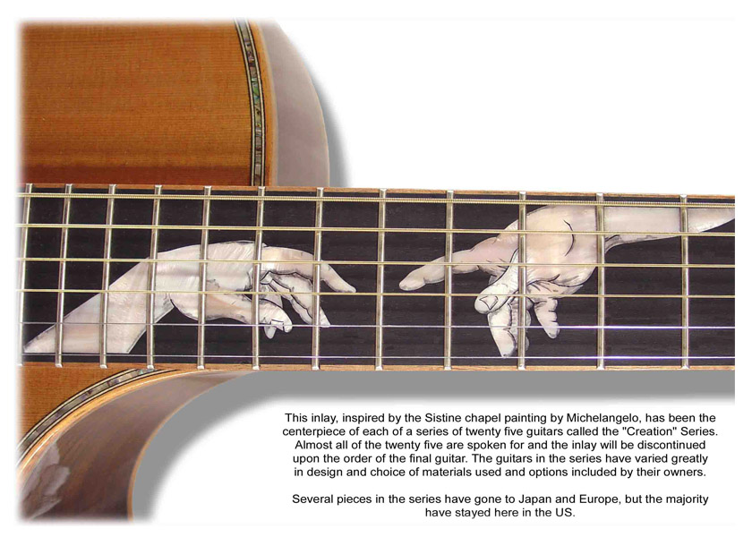

PostPosted: Thu Apr 05, 2007 5:15 am
Posts: 1041
     I hit the post button before I realized that i hadn't included the photo
that I wanted to. This is a photo of a very simple inlay done with slabs and
then detail being added with traditional style engraving.
    Thanks for taking a look.
Regards,
Kevin Gallagher/Omega Guitars

Wow, that's beautiful, Kevin. All the more impressive considering that
hands are about the hardest thing imaginable to draw (for me anyway).
Nice parsing, James.

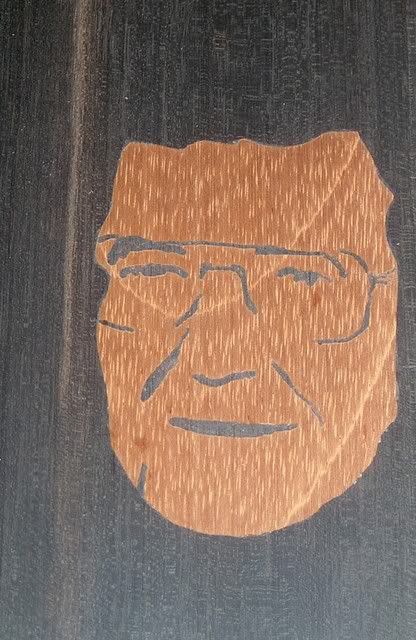

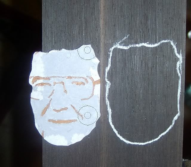

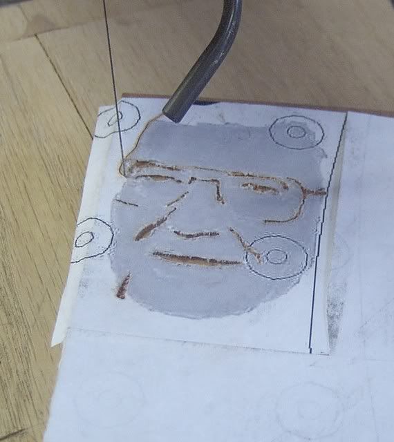

PostPosted: Sat Apr 14, 2007 2:43 pm
Posts: 1969
Here is my latest attempt. I took the picture and made a mono tone image from it.
I mounted the image on wood and routed out the detail and cut out the shape.
I cut out the shape on the headplate.
I filled the detail with ebony dust and CA.
PostPosted: Sat Apr 14, 2007 6:16 pm
Posts: 1209
Location: Ukiah, CA
That's a big improvement! You might want to use a wood with smaller pores like maple.
Ken Franklin
clumsy yet persistent
PostPosted: Sat Apr 14, 2007 7:00 pm
Posts: 587
Location: Tacoma, WA
Steve-
Nice one! I think you are coming along here. Like I said, I don't know a thing about marquetry but I am always trying to think of how things like that are done and how they are done in the most simple fasion. Please keep posting pics of the progress. I would live to see the finished results!
Christian
